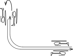

- Crisply pull the heli up 90 degrees and let it
continue in a straight ascent
- Using enough collective (and a sufficiently powerful
motor), you'll get much of the momentum during the quarter loop.
- After the piro, let it drop in a straight descent. Actively
resist the temptation to "squirrel out" immediately.
- Think of the pulled segments as quarter loops, ideally
circle-shaped.
- In the quarter loop on the way out, try to mirror the
quarter loop during entry.
- Carefully control collective so that the heli enters the
horizontal flyby without any sagging or "bounce" in altitude.
- Use for example a tree line on the horizon as height
reference.
- Try to give the illusion that your heli is running on rails
- Another "mental image" is a skateboarder in the half pipe.
